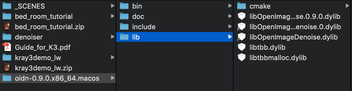

I replaced the 2 libraries in the Lightwave bin folder:
libtbb.dylib
libtbbmalloc.dylib
The OpenImageDenoise library is called right now libOpenImageDenoise.0.9.0.dylib
When I put it in the Kray folder I get the message the the library can't be loaded. Tried the following:
1. put it in the lighwave bin folder - no success
2. put it in the K3 plugin folder - no success
3. renamed it in the lightwave bin folder (to OpenImageDenoise.dylib) - no success

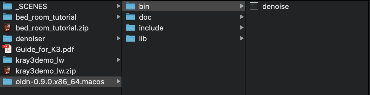

In the download from the site there's a bin folder, but only one file is in there named "denoise"

Anyone got this working on a Mac?
Thanks in advance ...
