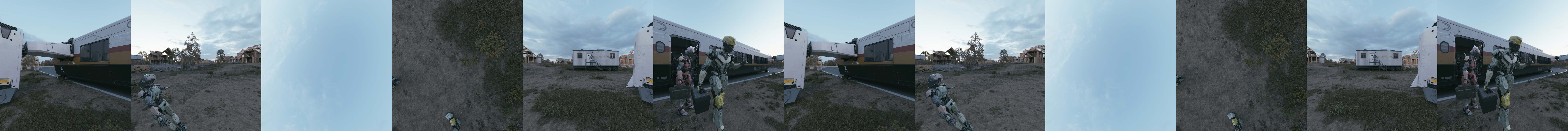

Here is correct stereo panorama in tile system (it is doesn't matter what system we use, I prefer two panorama Left/Right near each others - is much cleaner information)
You can check this is Oculus or HTC
