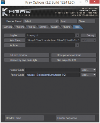

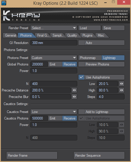

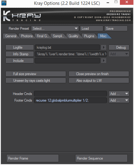

Here command:
It reduce power effect in global illumination - in this case twice.
It reduce three times
It reduce one and half

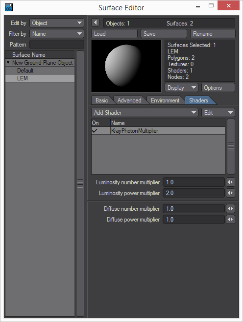

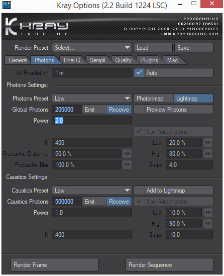

Here situation when we can use it or we have to use: Power Shader is standard tool in many Render Engines which allow user extend Tone Mapping. By this tool we increase power of photons without seeing bloom light effect.
I suggest use maximum Power 3.0 (three times more photons from light sources). Personally I use maximum 2.0 and command:
Attention
This is command which reduce bad reflection effect! Using Power Shader without this command will generate strong reflection effect - which will be not correct physically . This is normal situation in many other softwares.
If are any questions please write down here.
This tools can help very much to get better light in interiors but please use it gently.
Edit
This command gives metal feeling similar to Maxwell surfaces because reflection effect is "dimmed" . So it can be use (globalpmblurmultiplier 1/1.5;) also in standard render without Power.
Code: Select all
Attention
Edit

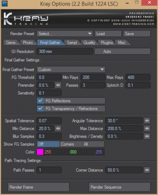

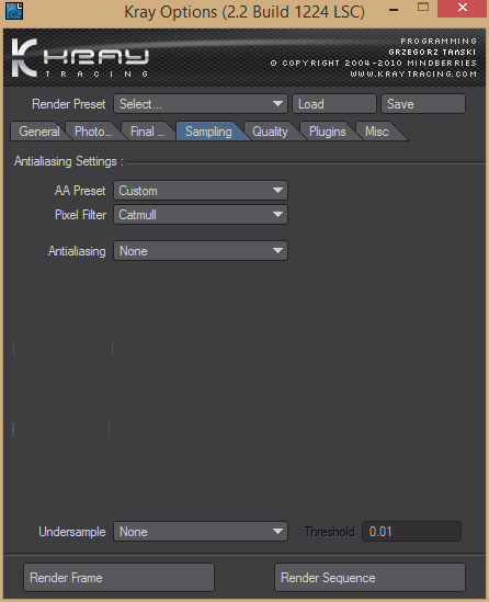

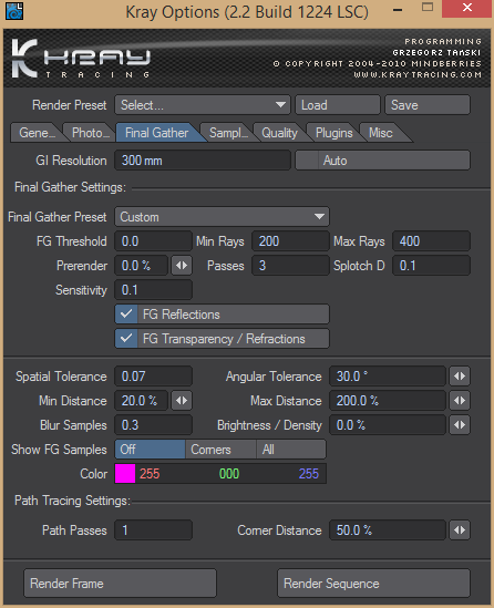

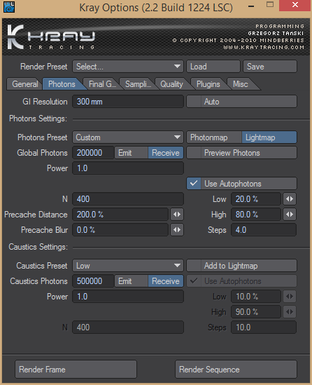

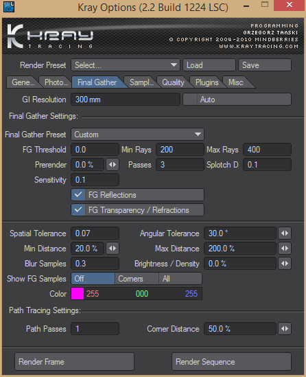

Here solution (it will be special button for that in K3):AVLKray wrote:As preview render times gets longer and longer maybe you can give some tips on how to get quicker previews
1. Switch to minimum 500.000 photons: 2. Disable prerender (passes doesn`t work when prerender is zero): 3. Disable AA (better is use Catmull filter - for sharper preview):

Why in step 1 minimum 500.000 Photons?
Re: Best recent interior setup?
AVLKray wrote:Why in step 1 minimum 500.000 Photons?
You can put 100.000 if room is small. But please remember to fill up space you need at list 1.000.000. I noticed then more we shoot then better is photon map (quality).
of course in GLOBAL PHOTONS RECEIVE we shoot photons from CAMERA to Light Sources. This save a lot time because we do not need shoot photons behind objects and in the end we get ~20.000-50.000 photons maximum. But is really better when we shoot more. This first step step save a couple of second if we reduce from 1 million to 200.000 for example. The quality is not so different then final render (please remember to back to final settings after preview renders ) but to see general light, colors, tone map effect etc is enough.
Why I want one button in K3 as fast preview with these settings. Of course main preview window will be VPR Kray (it works great) but I do not have yet progressive scanning so is lagging preview window, because K3 try render final image in a few steps (it will be same as in Fprime, smooth...but of course without noise )
