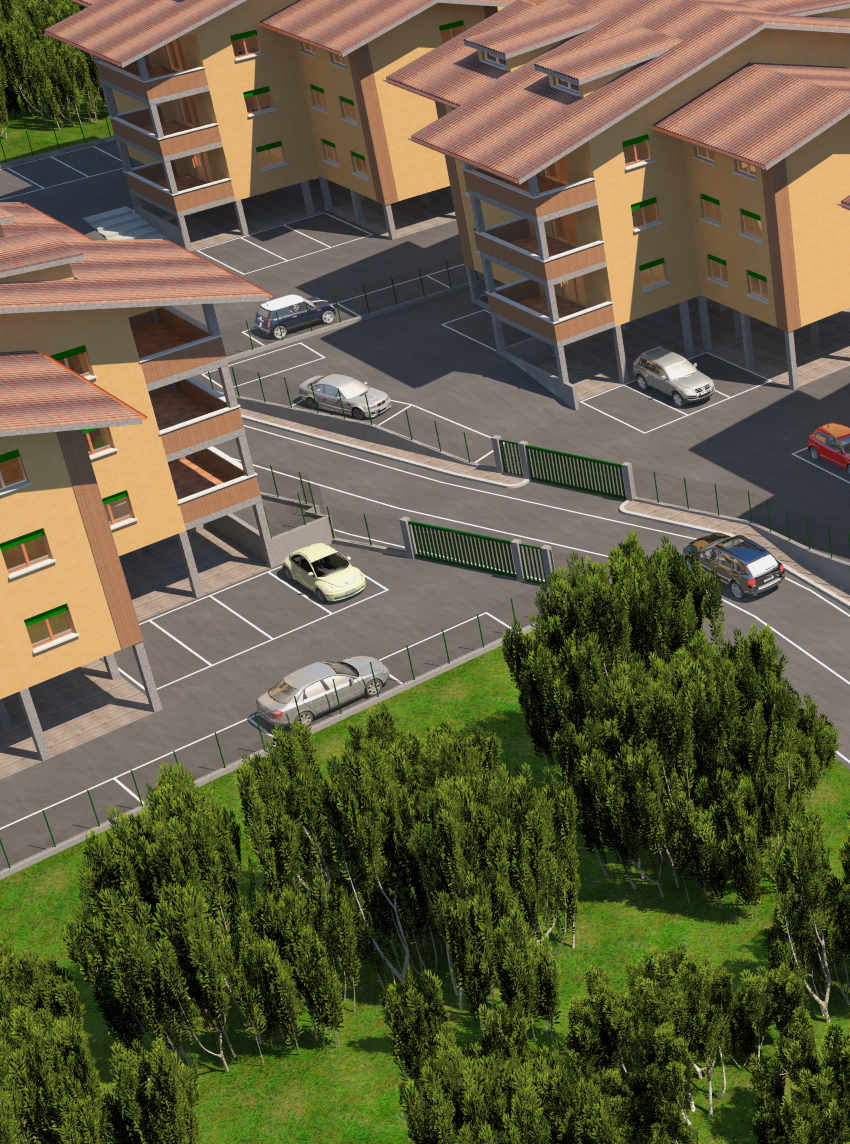

my problem with AA persist!!
for big resolution use quadratic 1.2 but the pixel are big!!! januzs why!!!!
the problem are for urban view!!not for near view but where the camera is distant from object isn't a good and clear AA!!

this is a part of complete render 4000x2000.
Re: Best AA setup for render

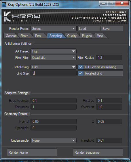

For me looks as mipmap problem in texture setup (of course if on the roof you have texture). Also I see still AA is too sharp. Are you sure about correct setup in AA tab? Screenshot of tab AA please. Also remember less exponential - bigger Filter Radius in AA. Exponential strongly smooth Filter Radius make it even more soften.

it's hempirical system for AA!!!
Why all this parameter?

...I have no idea what is the problem. You did not confirm also what kind of roof you used (real shingles models or texture map). Try change AA to another filter also.
If You have shingle wire on the roof maybe texture is wrong I see repeating from texture.
oh sorry only texture map...but i think the problem is zoom into the image!!!

If is texture (which I suspected) then problem is in LW setup or UV map or bad mapping projection. Kray render what LW give - except bugs in Kray. I did not notice last time something weird with texture rendering in Kray. Try also save this map in different formats (for example if You have jpg then save it as png, reload it and try render again - I think I had one time that problem)
