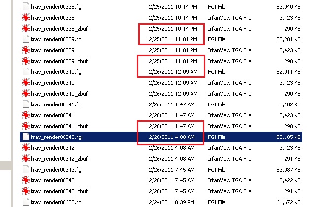

Hey guys, I just started test render sequences in Kray. For the 1 frame to 300++ frame it was really fast (5minutes ++ per frame) but suddenly it became slow. What happen with that?
Also I want to know that what is FGI. format file?
Frames - 341 1:47am
Frames - 342 4:08am
Which buffer I need to choose for motion blur effects? I heard that someone told me that use a texture buffer.
Re: RPF & Kray.
There is no special buffer for motion blur.
Your .fgi file is created when you use Time interpolated mode. But you should really be using Shared GI mode instead I think.

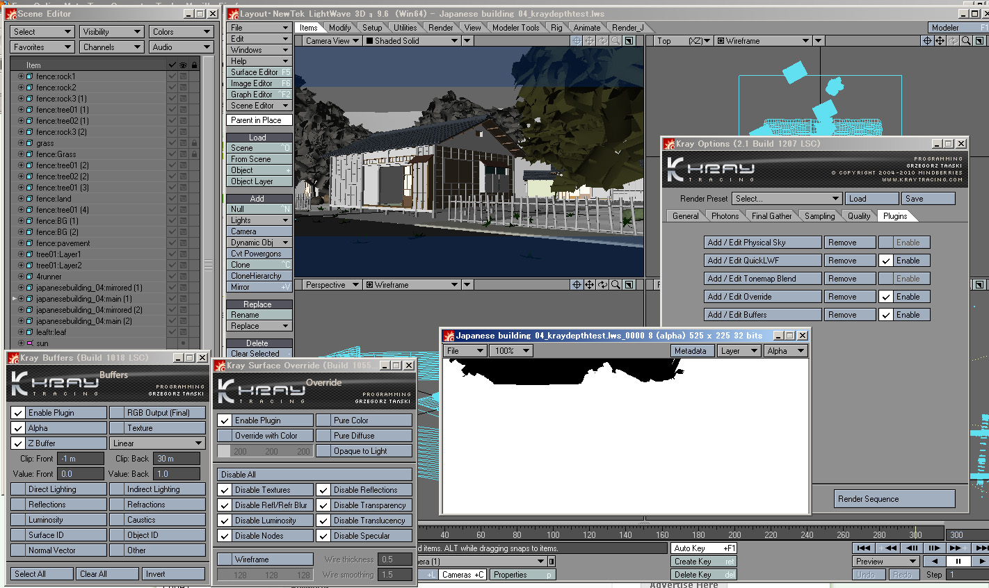

How can I render just only the z-buffer sequences?
If it can render just only z-buffer, it's fast or not?
jnom
Posts: 263
Re: RPF & Kray.
Post by jnom »
You can use fog trick in lw. Just use same classic or persp camera for lw and kray.
http://www.youtube.com/watch?v=LL_yqMUpz7s
I remember I had problem with clipmapped trees when using zdepth pass from kray or exr so I used fog trick. Renders fast because everything is turned off.

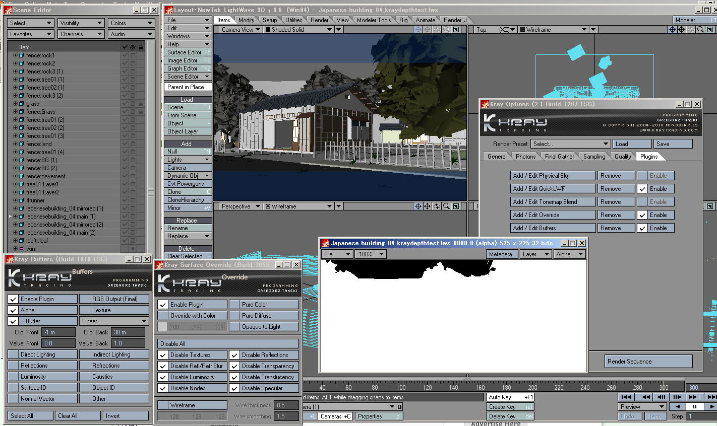

Re: RPF & Kray.
azman_821009 wrote:How can I render just only the z-buffer sequences?
1. Set Kray to Raytrace only mode and remove any shaders from surfaces
2. add Kray override and select "disable all"
3. turn off all lights and physical sky
4. add kray buffers and select only Z-buffer.
RGB render should be black but your zbuffer will render just fine.
jnom
Posts: 263
Re: RPF & Kray.
Post by jnom »
jure wrote: 1. Set Kray to Raytrace only mode and remove any shaders from surfaces
I tried this but can't get it to work and the clipmap trees solid. Any tip?
