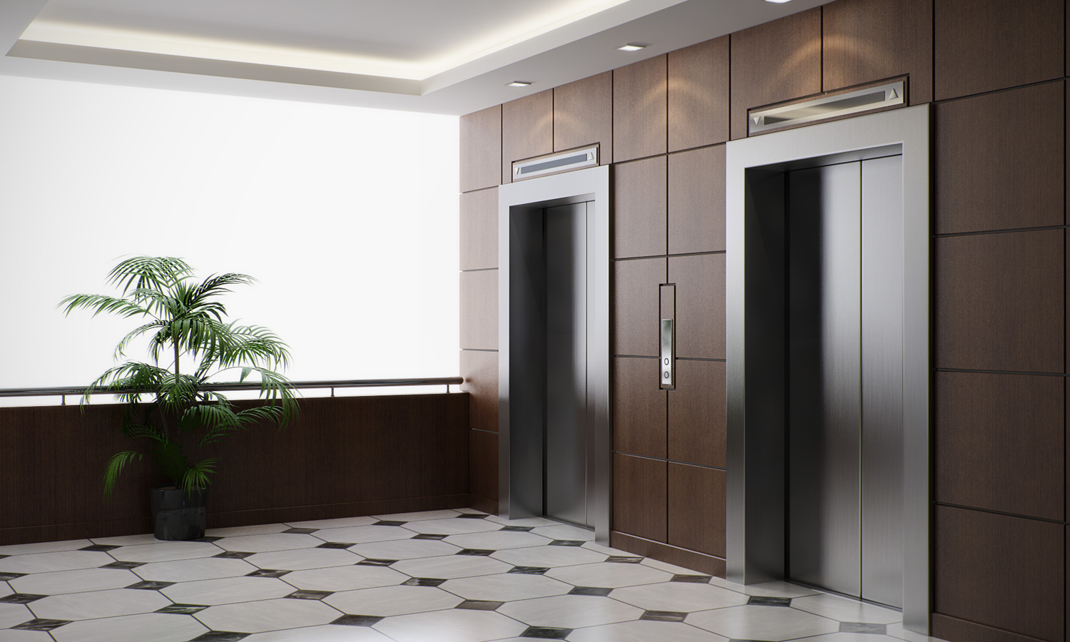

C&C are welcome. :)
acidarrow
Posts: 140
Re: Simple Scene - Elevator
Post by acidarrow »
Good work.
Now. The background is too blurry while there isn't a hint of DOF in the scene. So it just kinda looks fake.
Also some minor AA issues on the floor, but it's not too bad.
For elevator metal You need Ani -reflection NODE. It is better realistic metal.

i like very much! very nice render

It looks great. Good job :wink:

Another update
Add Ani-reflection, High AA,
Remove background.
Posts: 406
Post by salvatore »
very nice !!
What kind of lights are the spot over the doors? Photometric?

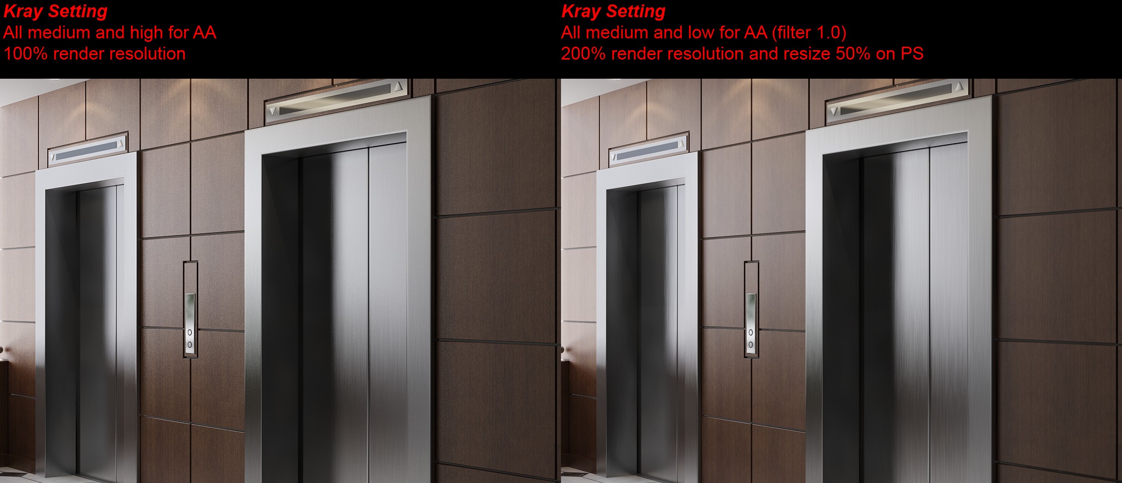

how_then wrote:Another update
Remove background.
looks better .
For High AA better is use: Grid2 box filter 1.0 no FSAA, 0.05 all + IMPORTANT double size. After that rescale under PS with bicubicsharper. But with this trick You must remmember: blurr must be HQ.
I use this, I know this is a bit longer (not much, becouse is no FSAA and only grid2) but AA after rescaling is perfect! (good idea is a bit sharpering image and after that rescaling).
Please remmeber: BOX filter is fast and size filter 1.0 is good for smoothing pixels.

Johny_quick wrote: For High AA better is use: Grid2 box filter 1.0 no FSAA, 0.05 all + IMPORTANT double size. After that rescale under PS with bicubicsharper. But with this trick You must remmember: blurr must be HQ.
Thanks Johny ...Will try later

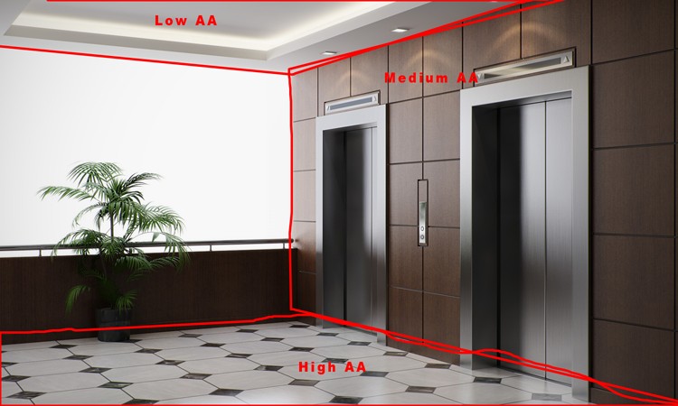

Is it possible to set difference AA for difference Surface or part???
Save render time.
refer for attachment.
Save render time.
impossible.
But You can try no FSAA, when You have clean surface without noise Kray calculate only outlines (so this part will be fast)

salvatore wrote:very nice !!
yes. is IES light.

Nice job. Like so much all textures and ilumination

thanks johny..your trick is really helpful. Render time is faster then previous render(high AA) and look smooth.
