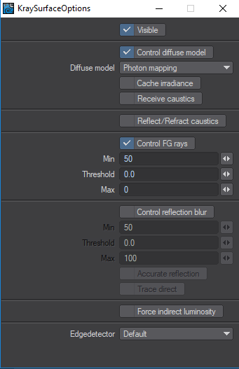

Hi, I have some problems with an exterior scene.
I'd like to render instanced grass, but the rendertime is incredibly slow compared to the non-instanced version.
With grass instances: 90 minutes
Without grass instances: 21 minutes
Actually the "without instances" version also contains the instanced grass, but it's moved below the ground, so it can't be seen (Y=-575mm instead of the normal -75mm)
What occures the 4.5x rendertime??
Link to scene: https://drive.google.com/file/d/1Nqv_3n ... sp=sharing
Re: K3 - Grass instances
Posted: Sat Sep 08, 2018 5:19 pm
by Janusz Biela
This is logic:
- your grass are polygons (hundreds thousands)
- every polygon need to be calculated by GI
- every polygon need to be calculate by Anti Aliasing
Solution:
- use K2 shader with low QMC:
Screenshot 2018-09-08 18.17.13.png (17.63 KiB) Viewed 57117 times
You do not need calculate so strong with GI these small objects.
You can use also this for Path Tracing (instead QMC select PT)
Because grass object is very small you will not notice noise from low GI sampling.
Very good system also for carpets.
