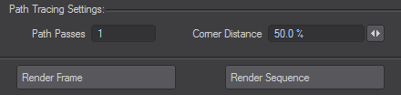

Everything is ok. This "strange" behavior in corner comes from Photon Map Cells which takes information from outside - cells has "physical" size as interpolated simulation of real photons. This is normal and common everywhere and to correct errors, render engine must shoot extra Path Tracing photons. In Kray this correction tool is in FG tab called: Path Passes. Is enough to shoot one bounce light Path Tracing photons with 50% distance from corner:

Here's my latest render, using Path Pass 1 / 50% (which does work great), at double HD and with some colour grading and a very mild DOF.

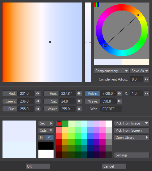

This looks good. Now you can add Power Shader for LEM light in window:
plus Kelvin colour scale for this light:

1) About the colour: the Kelvin value just get converted into RGB values, right? I changed it as you said, into 7720 Kelvin. Very slightly more blue overall, but the change is so subtle that it gets lost in the colour grading. My previous colour was 235 / 245 / 255. Your Kelvin colour is 231 / 236 / 255. Not that big of a change, but it looks nice!

This Kelvin scale is just example (of course should be more blue) and is better use Kelvin colour scale then setup sky colour from a hand. Better idea is to use Physky plugin but in Kray this system is old. Situation will change dramatically with Physky2 in Kray 3 where simulation is much better, gradient more realistic.
