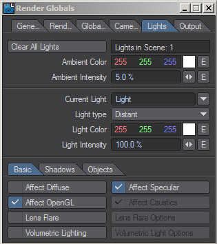

Hi,
Our lighting artist ran into an issue with lights and kray. She want to add specular only to buildings - so "affect diffuse" in light properties OFF. (I know not to use specular, but we just use it on some shaders to give the last missing lighting on edges)
Gives her a nice specular effect in native lightwave render.
But with kray render it does not recognise the affect diffuse off setting and renders also lighted diffuse.
Any settings or tips on this matter?

The flags which you select doesn`t work in K2.

Here's the ASCI of the scene, might be interesting to get it from there: (downside is you have to save everytime you change the setting before kray could capture it)
Diffuse on: no text added in asci of scene
Diffuse off: "AffectDiffuse 0" added to asci of scene
Grtz
