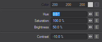

- after multiply You can notice Color Tool ...and this is my small update also. The Fresnel effect seems for me too strong on the edges and too weak in center (Yes! It doesn`t mean it is correct in render because is done according to physics!) so I reduce this effect by Color Tool all the time in the same way for all Nodes + I see effect of connection which is very important. This level give me the best results (small correction tool for Fresnel effect):
- sc_015.png (3.91 KiB) Viewed 14466 times
This part never change! Always is the same for all surfaces:
I slowly add one more update. As we know dark and bright surfaces has different Albedo so I think for very bright surfaces system of diffuse should be as images before but for dark surfaces Subtract should go down to minimum 0.6. I notice dark surfaces with reflections are not that dark as should be. Last time for dark ceramic and similar I change Subtract to 0.6.
Color Tool is the most important Node from all. By this you change everything:
