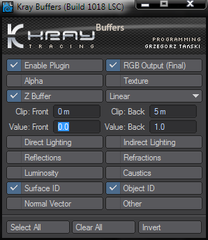

We are rendering some animations with kray but I have a problem with the output names.
We have now: name_0000_alpha.hdr
But we should have: name_alpha_0000.dir
Cause fusion doesn't recognize them as a sequence. Is there a fix for this? Cause otherwise a have to batch rename a lot of files, which is also a bit dangerous to do...

There is built-in solution for your problem
You can use whatever naming you want by using the following variables in your filename:
%frame% Current frame.
%buffer% Buffer name (if rendering buffers other then RGB, see needbuffers).
Default format is %frame%_%buffer%.
In your case all you need to do is to change it to:
name_%buffer%_%frame%.hdr
You can use several other variables in your filename. They are listed there: http://www.kraytracing.com/wiki/Advance ... _info_text

To complete information where, what and how:
In Kray output setting, example:
Code: Select all
will give us:
Code: Select all
But if we select buffers in Kray:
will give us:
Code: Select all
