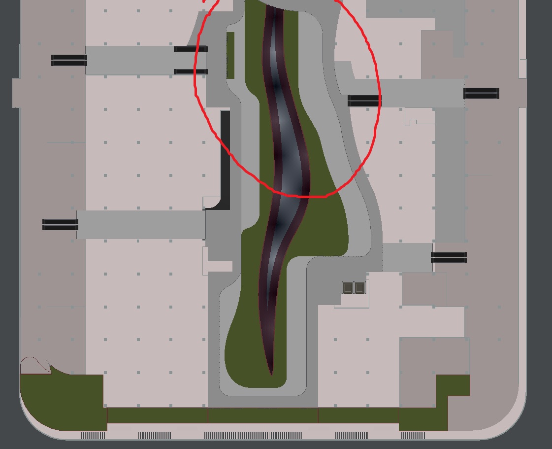

Thanks Jnom. Maybe for the forest or open area is easy to use kray instance. How about the landscape at the center of the building? And the grass level is not a same level, for example like a hill or else. This is the top plan which is the green color is a grass and red mark is something like a hill. So how can I use kray instance for this situation?

by jure
You know I think instanced grass is overkill for large scenes. It's better to use "Paolo's grass" method. It renders extremely fast and looks good. And it's easy to setup, just clone the grass surface 50 or so times and you're done.

jure wrote:You know I think instanced grass is overkill for large scenes. It's better to use "Paolo's grass" method. It renders extremely fast and looks good. And it's easy to setup, just clone the grass surface 50 or so times and you're done.
OMG!!! Thanks Jure.. I think this should be work perfectly.
