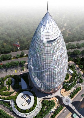

Hi everyone,
I just finish tried rendering with Kray. I needs some help, how can or which part I need to re-edit/adjust the rendering?
Also, I have a problem with the Kray Instance which is the angle some of the trees was not balances.
& how can I make more realistic steel on the main object of top of the building?
Hope some of you guys can give some tips or help.
Thanks.
Azmen

It's hard to see what's wrong with instances in this image. You would need to show your setup.
For metal you need a good reflection map...

Some pointers:
1) If the roof is made of steel, and with the sunlight falling as it is, there should be a strong specular reflection somewhere, which is missing now (unless you would paint your steel roof in a supermatte paint, but then it wouldn't look like steel anymore.
2) If the sun is as strong as it looks in your render, I would think that the sky would be a beautiful open blue sky - this would make that black shadow of the building a lot more blue and light, because that area still receives light from the sky.
3) If you're going to make the roof reflect more, try using a gradient in lightwave in the reflection channel, with the input parameter set to incidence angle. Then make the sides (the "glancing angle") more reflective than the frontal area, to get a good fresnel effect. The fresnel effect is crucial for good reflections, in my opinion!
Cheers,
Thomas

jure wrote:It's hard to see what's wrong with instances in this image...
You mean apart from the trees growing on the highway? :) It looks like a pivot problem to me - Azmen, is the tree you're instancing centered in Modeler? Cos if it isn't and you apply some rotation to the instances, they'll end up all over the place...
(Impressive building, by the way)

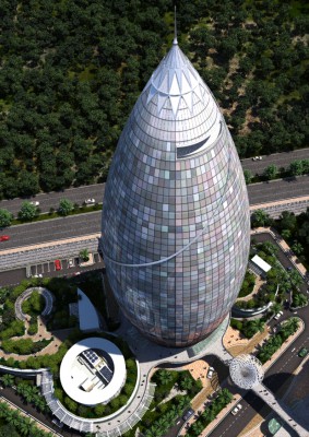

Thanks for the tips and helping me guys, really appreciate. Attached is much better than the earlier. :)
Latest rendering of image and 'Kray Option' setting I done for this render. This image resolution is 620 x 877 and its took more an hour. This is ridiculous. :( I am not really sure I did wrongly with setting or others. It's just started and I plan to prepare for next step as I need to render it an A0 paper size for advertising. And to prepare for the animation HD 720p format soon. So I am really, really, really need help and advise from the expert in Kray user, how can I reduce the time for rendering but need the high quality and more realistic.
Anyway, I need some comment about this image so I will adjust to make more realistic and nice. :wink:
Intel i7 Xtreme, 8gb memory DDR3, Nvidia GTX470, Windows 7 64-bit
Thanks.
Azmen

For speed on all vegetation put KraySurfaceOptions shader and select:
Photon mapping
cache irradiance OFF
Control FG rays: min 1 max 10

Hi everyone,
This is my final rendering,2480 x 3508 resolution. Appreciate any comment about this rendering with Kray from you guys.
Should I adjust the lighting, Photon, FG, Sampling, Quality setting or else. Rendering took more than 5 hours . It's that normal? I am suppose to re-render again, double this size ( maybe A0 size ) soon. Just tried to render that size but the 'remaining on the render log said' it's gonna take about a week to finish the rendering. Is it because of too many trees using Kray Instances? Really appreciate if you guys can help with this problem.
I too was trying to render with DOF and it took about 7-8 hours. Used standard preset render setting - Medium and just adjusted on the Sampling tab > anti-aliasing > Grid > Box > 0.8, FSAA. Others are same setting as standard.
Thanks.
Azmen
Compress Image
Compress Image
Render Log
Render Log
Intel i7 Extreme 3.33Ghz, 8 GB Memory, Nvidia GeForce GTX 470 1280 memory, Windows 7 64-bit

5h time render is ok.for that view I think You do not need DoF (but if you like better is use Z-buffer and DoF Pro , same time render, better control, also You can use Z-buffer for fog effect ) This time from Kray log are very theoretical time, if you need more exact time please use PIXEL ORDER RANDOM in GENERAL TAB)

Effects like clouds, motion blur and DOF are all better to be done in post. It's faster and you have more control over it. 5h may be much but it depends on what kind of CPU you are on.
To get more realistic image I think you need to fix your material on the main building. From the picture I can't really see what kind of material is it supposed to be? The ground looks realistic enough from this view I think.
