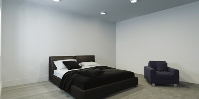

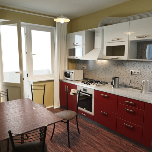

hey im really happy searchin all days and ifound it . how to get the same result as modern render as k3 but in k2 .
so in k2 everyone know u cant get nice shadow from lumi only if u just choose direct light in luminosity model so u will get some noise and u can reduce it very clean in photon tab and fg . but u will lose indirect compute . sooo i found solution as indirect luminosity model u get the many many shadow in side room ^^ :D .

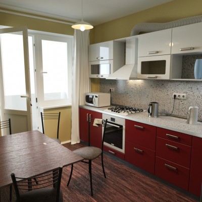

here test with kray 2.62 using Kitchen fstorm from janusz .
first raw. QMC .
first raw. QMC .

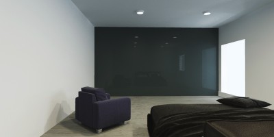

other view
Re: New Trciks in kray 2.62
Hq

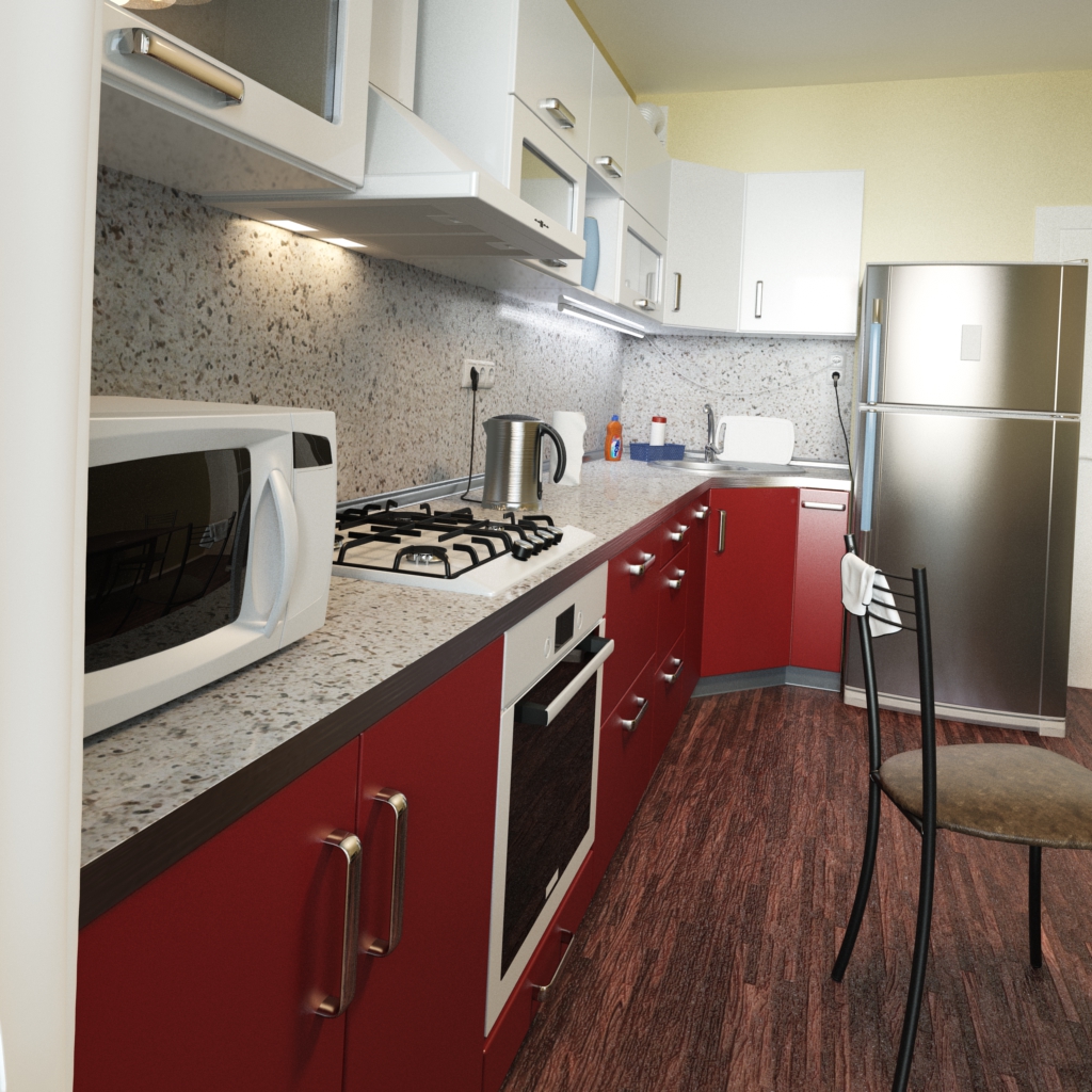

kray 2.62 other shot 1H render 1200 rays QMC Hq.

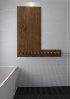

Hey artAttak thank you for your feedback .can u plz tell me wich scn it took 100/100 long cause in my caise all scn it work the same. or mybe u put something wrong .
my tricks is to put 2 area lights for each light sources and use photonmultipilier to get nice shadow in side room without affect gi and too much diffuse of ur model. im working on bathroom . when i frinish it i will put it with this new method for everyone to lean this one . and for all kray user can acheive photo realsitic easy mybe its long 10min differance but the render is very very nice. thankyou ! :mrgreen:

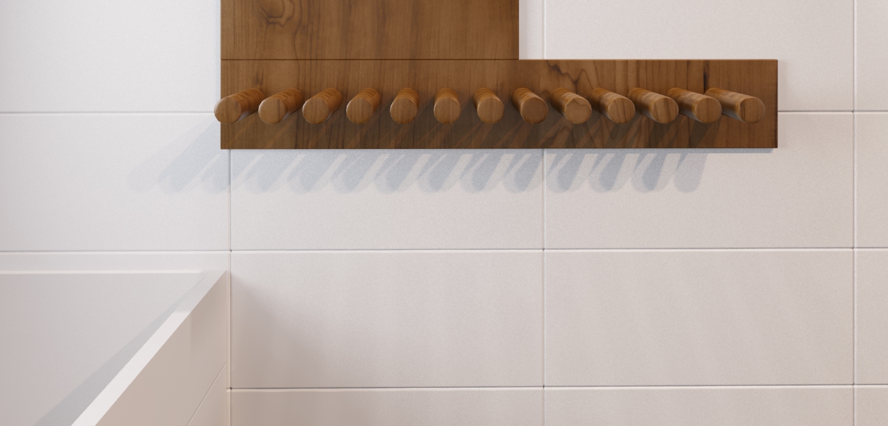

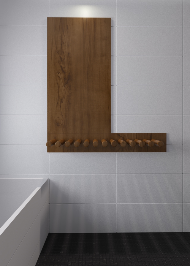

this is my tricks look pls how much shadow we have in this bathroom without affect gi and diffuse too much i have 4 shadow here . and know the one is next ground if u can see it.
here i have 2 light.
one from out side window . and 2nd one u can see it it above it didnt affect gi .

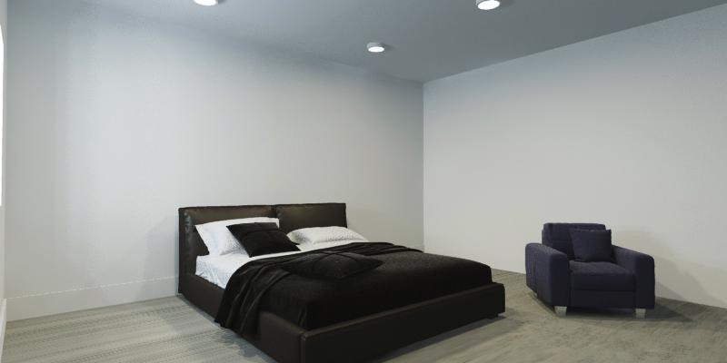

here my first attemp on this tricks . i was playin around too acheive many light and shadow in side room without get bright render .

hey sry for long reply. well if u want to have many light inside ur room or kitchen or bathroom . u need to use area light without invers dist x2 . it mean u will use basic area light and u gointo motion tab : u add photonmultiplier and put 0.3 or 0 depend how much u want to light affect difuse and gi . soo with this method u will get many lights inside ur room without affect gi = sooo u will get nice diffuse and normal render not white or bright :D .
ty if u didnt understnad put ur simple scn .
