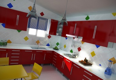

Hello guys, well i am so time here and this is my first real render full with Kray.
So much time to learn all how & why.
Of course open to sugerencies and comments.
Render time: 3h 20m (15 mins with mid setting, i need to learn to optimize the scene i think)
Micro: Q6600 4x2,4ghz
Thanks
My First Interior

Very very good
Two points i can think of:
- im sure those wall tiles dont go up to the kitchen ceiling in that arrangement, and it feels wierd... maybe just paint the wall a light yellow?
- there is some scaling gone wrong in the sink area, and the kettle looks a bit too small.
- you could give the direct sun light some warmth and balance the indirect light to get some more contrast in the scene.
I am sure you could get much better render times by following some of Johnny's advice around the forum.
Cheers!
Cheers!

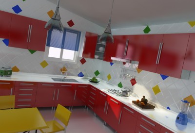

Re: My First Interior
I make some changes following your comments and checkin again all setup help on forum
1.- Rescaled the kettle +20%
2.- Optimized and constrasted lights
3.- Optimized glasses
I think now are more contrasted. On later version all scene have a red ambient that i dont like.
Render Time 1:09
What do you think?
Render Time 1:09
What do you think?

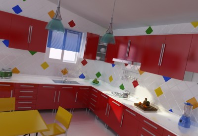

I think you have too much reflection everywhere. Do you use reflection modified on incidence angle?joreldraw wrote:I make some changes following your comments and checkin again all setup help on forum
Render Time 1:09
What do you think?

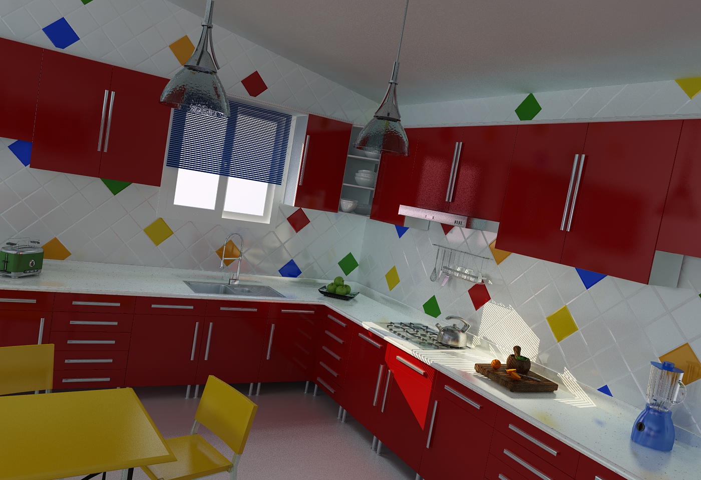

Well, i make some little changes in my scene.
Deactive Convert to area
Fixed high reflections and improved some materials.
Fixed render times 21m 15s much much thanks JURE for your help and patience
Much better! Use higher AA in final image.
