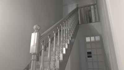

I am working on a interior scene, and i experienced a weird problem..
I got a object (stair ramp) that does not react to texturing. i get reflective surface on it, as i only have 100% diffuse.
Same if i change it's color, it does not render well and keep spec and gray/white color.
In the lw Renderer i get it working properly.
(I did set it up before with a fesnel node.. but as kray kept crashing, i removed it)
Someone has a clue on what's going on?

After a few hours of searching tweaking and so, i found the origin of the problem....
I did name the surface with a accent (stupid error from me).... so i could tweak the surface as much as i want, it had no influences on it in kray.
So every thing should be working fine now...
