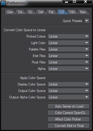

The other question I have is that now LW has color managment, does that mean I don't need to use the plugin that comes with Kray for gamma correction? In other words, does Kray respect the color space set that I set up in Lightwave?

If You use Kray for render then all color space should be setup to LINEAR in Layout (default).

And when you said I should set everything to linear, do you mean all the image maps as well ? Currently I use the RGB preset and change my normal maps to Linear.

Setup in LW should be default: Linear.
Lightwave after installation is ready to work with Kray without any special setups.
