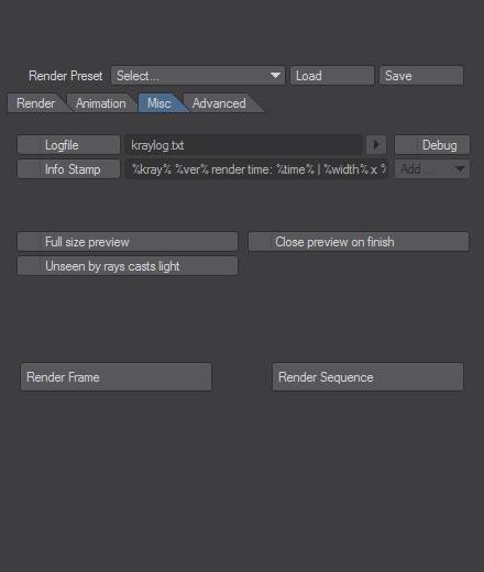

Janusz, what is the best procedure with kray vpr resolution?
When I set the render size to full hd, the preview window gets too big. Can this be resized? There should be also a zoom and pan inside the window to view details in the render.
Regards.
Re: kitchen minimal
Posted: Sat Dec 31, 2016 5:31 pm
by Janusz Biela
Asticles wrote:Janusz, what is the best procedure with kray vpr resolution?
Regards.
Just disable Full size preview:

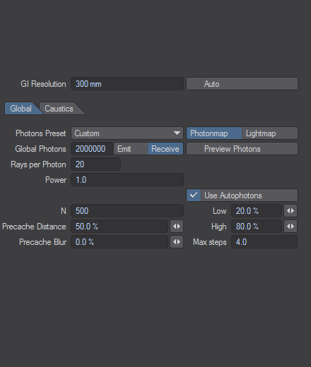

For VPR you must shoot always photons before. Is just better to use PPM for now - up to moment when PPM will be connected to VPR.
Remember, first time when you start VPR in scene you see ray tracing render without photon map. In case of use VPR you must use Photonmap:
System shoot photons from light sources so they are everywhere and is not dangerous situation when you rotate camera and you see dark behind.
Is one small problem with Photonmap: you must shoot enormous amount of photons. At least 10.000.000 multiply by 10 or 20. You must be sure that all photons penetrated all corners in scene. It takes 20-120 sec but after that you use VPR like in FPP game waiting for refresh.
