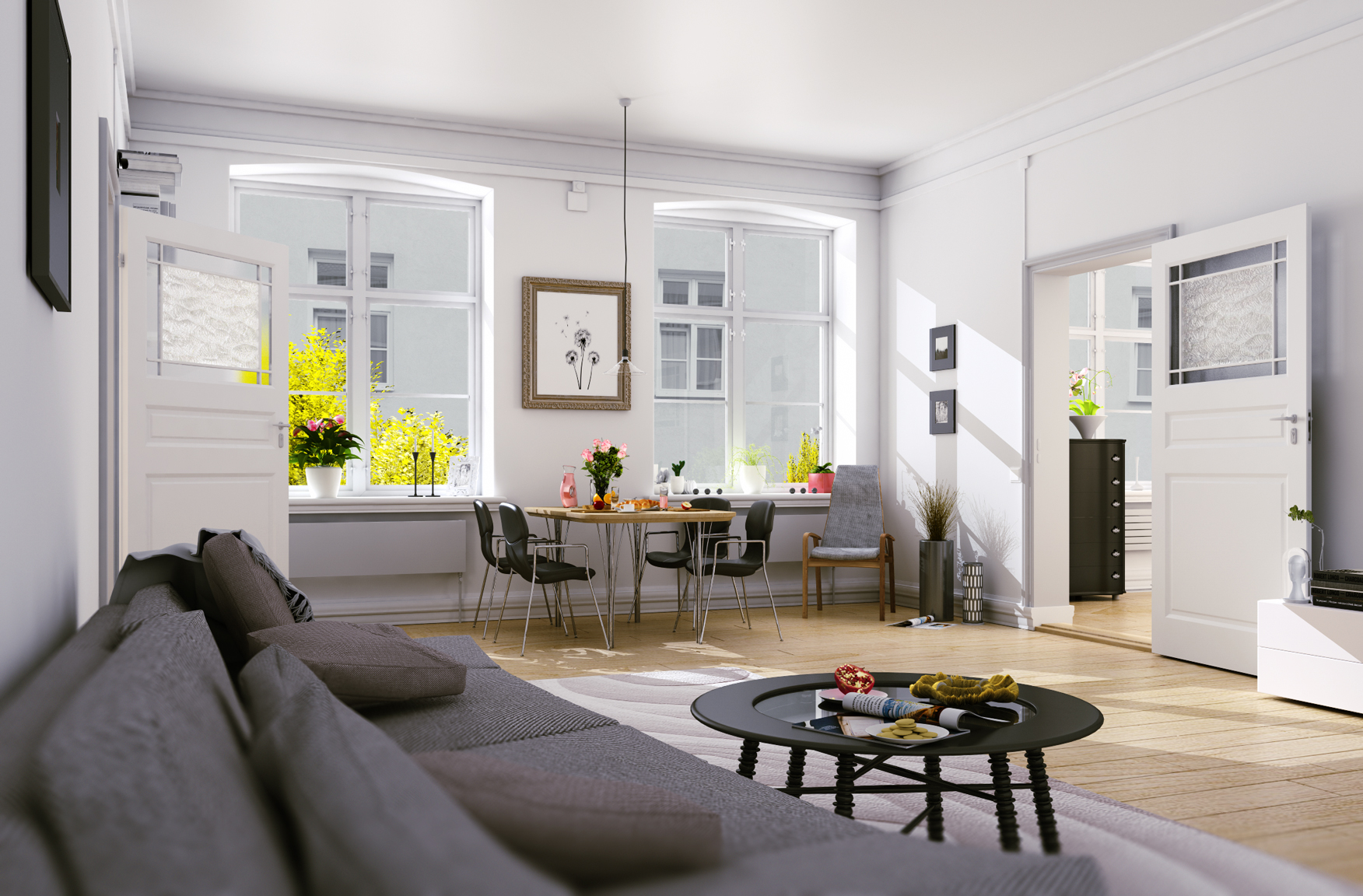

Posted: Sun Aug 02, 2015 11:52 am
by artzgodka
work for GI testing
rendered ni Lw native engine
i hope you like it
best regards
Artur

by Janusz Biela
Very good stuff like always! Lately, LW Native Engine has been increased with speed and quality...except problems with LimitDR (watch legs from table and chairs). Problem with LimitDR (Dynamic Range Ant Aliasing) is very difficult to solve because it needs very good tone mapping solution for reduce this bad effect. Anti Aliasing engine filter has always problem to smooth pixel in region where high contrast pixels (very bright and very dark) are in small distance near each other.
It is common everywhere but in Kray this option works surprisingly very good (in Kray menu: General Tab - LimitDR before tonemap). This problem sometimes is very annoying and very often people just render image in double resolution and rescale render down later in PS (of course loosing time render).

by Keraressi Abdelkarim
to get more bounce like kray u need to increase indirect rays in radiosity very easy engine secondary bounce ex... to get the same render as kray in lw in this situation. area light out side. u can u see lumi panel on windows but lw has hard control when it come about many thing to setup luminosity good luck.
