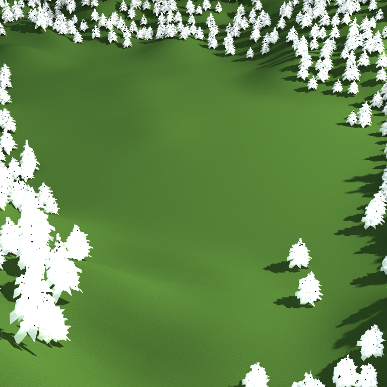

Yesterday I reduced the tree models to 500 polys each (down from 2500) and it actually rendered and didn't crash; however, it took 8 hours to render and when I arrived at work this morning all the trees were messed up; they were bright white (see attached image below.)
Broken low poly trees :(

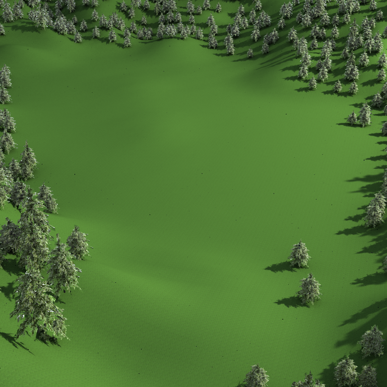

Thanks for the reply. That last render worked, took about 12 hours total. Below see the finished image!
The only problem? My boss wanted more trees. So after doubling the amount of trees and leaving it to render for a long weekend (from Friday to Tuesday) I'm back in the office today & the render STILL had about 4 days 4 hours estimated remaining? So there's still a problem apparently...
Would uploading my full KRAY settings help? What else could affect render time so much? It pretty much locks up at 0% again... not sure what to do!
Thank you again for all your help!
